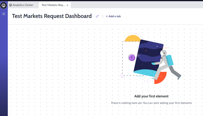

I've set up a Platform Analytics dashboard:

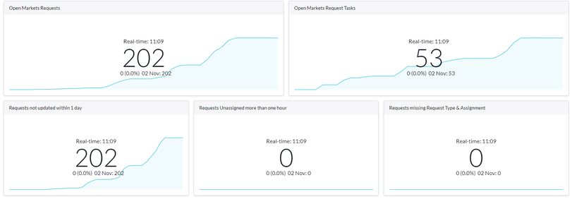

I'm wanting to add Performance Analytics widgets from one normal dashboard onto my Platform Analytics dashboard:
However, what I've noticed on the Platform Analytics dashboard is that when I click on 'Add new element', I can't find the relevant option:
If I select Data visualization and look at the visualization type list, I can't see one for adding a Performance Analytics widget:
Can somebody explain how I include Performance Analytics widgets one normal dashboard onto my Platform Analytics dashboard?
