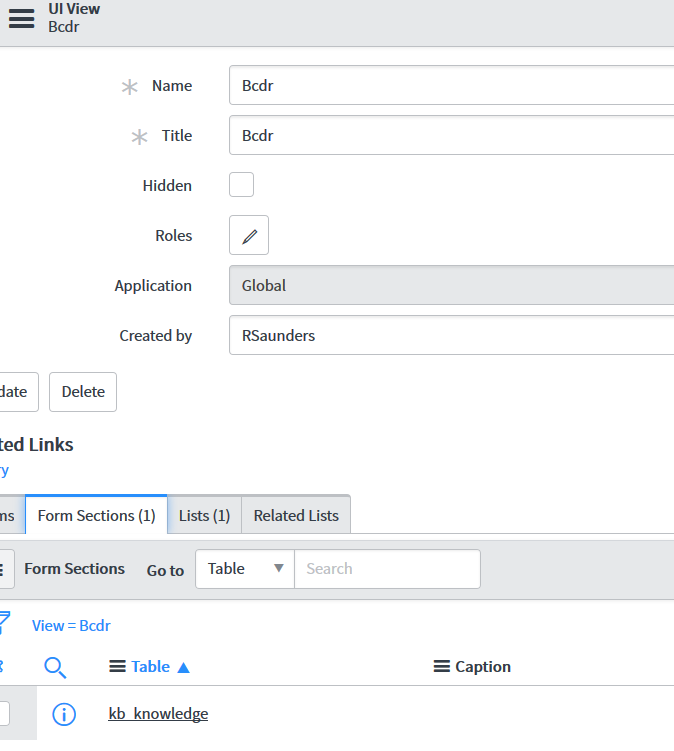

I have created a specific View Rule, as seen below:
Then this is the System UI > View that I created:
What appears to be working for this View Rule is the specific Form View (Bcdr) when editing an existing record.
What is NOT working is when I click New in this specific KnowledgeBase AND the form list view does not change, even though I have a specific BCDR list layout created.
What am I doing wrong?
Thank you Samiul!
You got me thinking the ways in which the View Rule is fired and figured it out!   I thought to look at the System Definition > Modules and searched for the specific Knowledge Base module item, based on the screenshot below.   I clicked on the Link Type and sure enough there was a field for View name.     I put in the specific System UI > Views view name and it solved my problem without the need for the View Rule.

When you are creating new record, is that field "knowledge base" available on the form and has it's value set to "Business Cont..." ?
Thank you Samiul!
