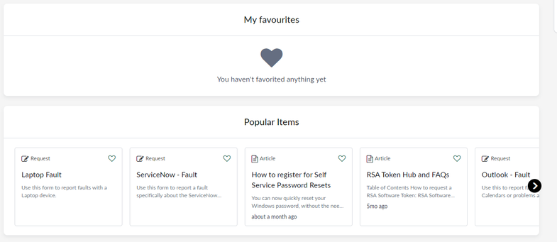

I'm using two OOTB widgets on my employee centre page - Your Favorites and Relevant for you:
One requirement is for those two widgets to appear side by side as separate tabs. Can somebody explain what I need to create two tabs for those different widgets like the below screenshot:

Hi @Rajesh Chopade1  I've added the widget and replaced the SYS IDs in the tabbed widget, but it's not showing anything:

Hi @Rajesh Chopade1  On my portal page, with that code, I'm getting the below:
When I click on either of those tabs, it's not showing the content of those widgets even though I've specified the Sys IDs. The end of URL shows #tab1 or #tab2
