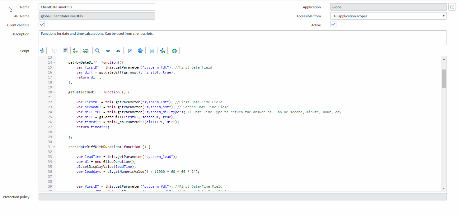

Hi Kevin,
We have a solution for this in our instance but it is quite elaborate and not sure if it needs to be this elaborate but here it goes:
We have an include script that has a bunch of functions within it, the important one is 'getDateTimeDiff'
the code for it is here:
We call that function back in a client script and this is how we have the client script set up:
The UX you get from this is when a user selects a date that is before the start date, it throws an error with the text you see in the Client script towards the bottom, when they click ok on the error message it clears the field so no value is stored.
Hope this helps
