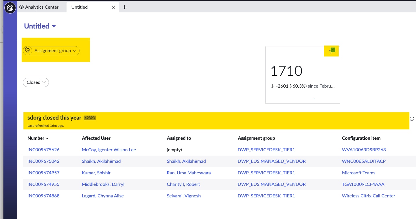

In the new platform analytics workspace, I'm trying to get a simple list to follow the filters I created.  I'm not seeing how to enable follow filter as we have on the platform dashboards.
The filters seem to work with an indicator, but not the simple lists.

ok- following https://docs.servicenow.com/bundle/washingtondc-now-intelligence/page/use/par-for-workspace/concept/...this video, and building in our WashingtonDC instance- the filter has a "filter element" type that our Utah instance does not have- I can choose "pill or type ahead".    When I first added the simple list element- it would not follow the filter set to Pill.  I messed around with the element changing it to 'type ahead' still nothing.  but when I changed BACK to Pill- then it started working.  I've tested back again on 'type ahead' and it's still following- so I don't think it has to do with the actual value of pill or type ahead, but maybe time or getting the filter to refresh itself?  It worked right away with the gauge element- so who knows.
Now to go back and see what I can figure out in our Utah, or wait til our Vancouver upgrade next month on most of our instances and see there.
Adam43
yup- looks like just refreshing a couple times, and maybe waiting a bit- the simple list in Utah does eventually start following the filter.  I'd call it 'cache ghost' just to put a name on it- but can't really pinpoint what I did exactly.
