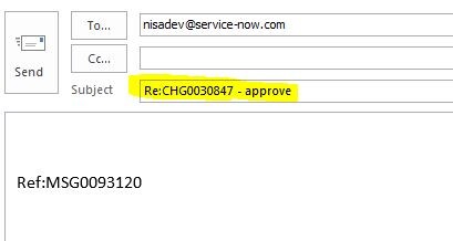

‎09-17-2015 07:04 AM
Hi Cory
I have created a field in approval reply email something like "Please provide Approver 1 email".
So, the approver has to enter an email id there and I need to read that value from the email reply
Can you please let me know is there a way for this. Please let me know how the script should be like
Attaching screenshot
