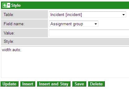

Hi Salvador,
                          Right click at Field OS and select "Personalize style". Then click new .
                      Write the script in side style is width:auto;
Harish.
akt_snow
Giga Expert
You won't be able to use Personalize styles as it is a Catalog Item. Style only works for form fields.
You might want try writing a Catalog client script to customize the style.
