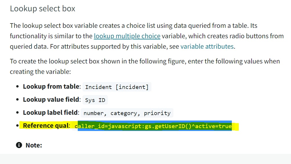

Where to write the script will be as under Variable attributes or Reference qual or create a Catalog Client script
If answer to question- Need access to a research lab is Yes, show Room Location country USA state is CA

Try passing below as Reference qualifier
javascript: var query = ''; if(current.variables.variable_name == 'Yes') query = 'country=USA^state=CA'; query;
//replace variable_name with room location variable name
suvro
You can use the reference qualifier to set a filter
You can write a client script onChange of  Need access to a research lab.
But I would suggest having two lookup select box one with filter other without filter. If answer is Yes display the filter one otherwise display without filter one using UI policy
