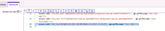

Thank you so much for your post and the example your provided! I am in the same situation as you, where I just want to filter by static date values e.g. for the month of January 2023, February 2023 etc as individual filters.
I used your example code line (with some tiny word changes):
However, for some reason the filter doesn't do anything when selected, please see attached code snippet above.
Can you (or someone else) please see anything which doesn't look right?
@Todd O Would you be so kind as to share a screenshot of your working code in-situ as way for me to compare?
Any assistance with this would be greatly appreciated!
