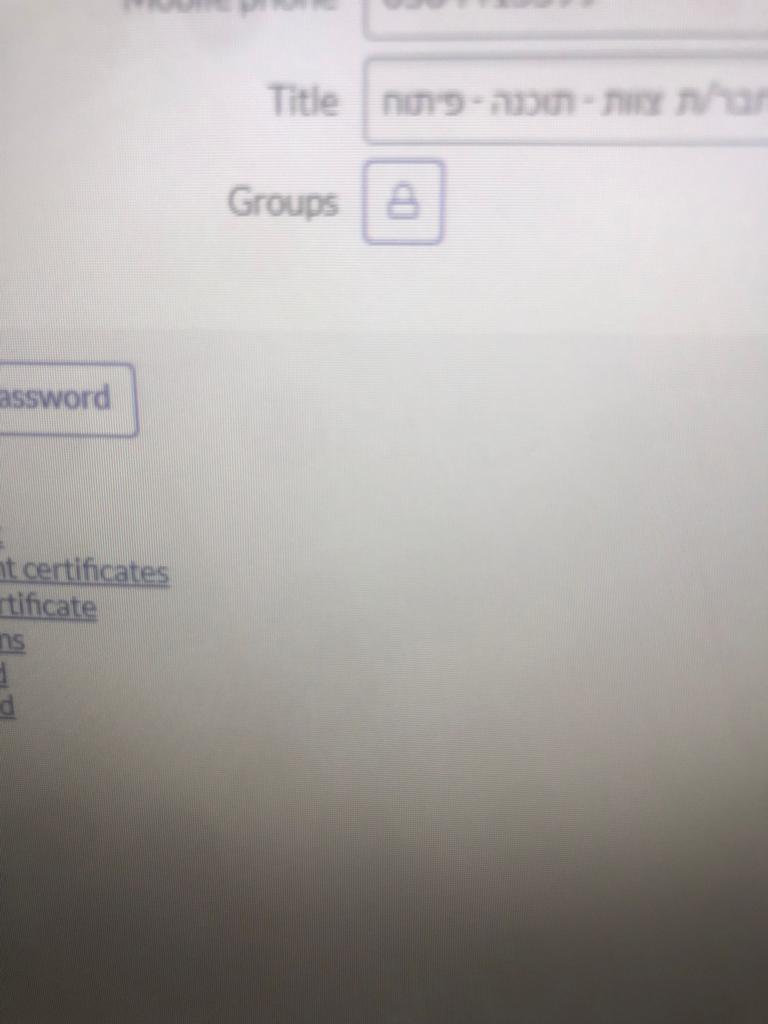

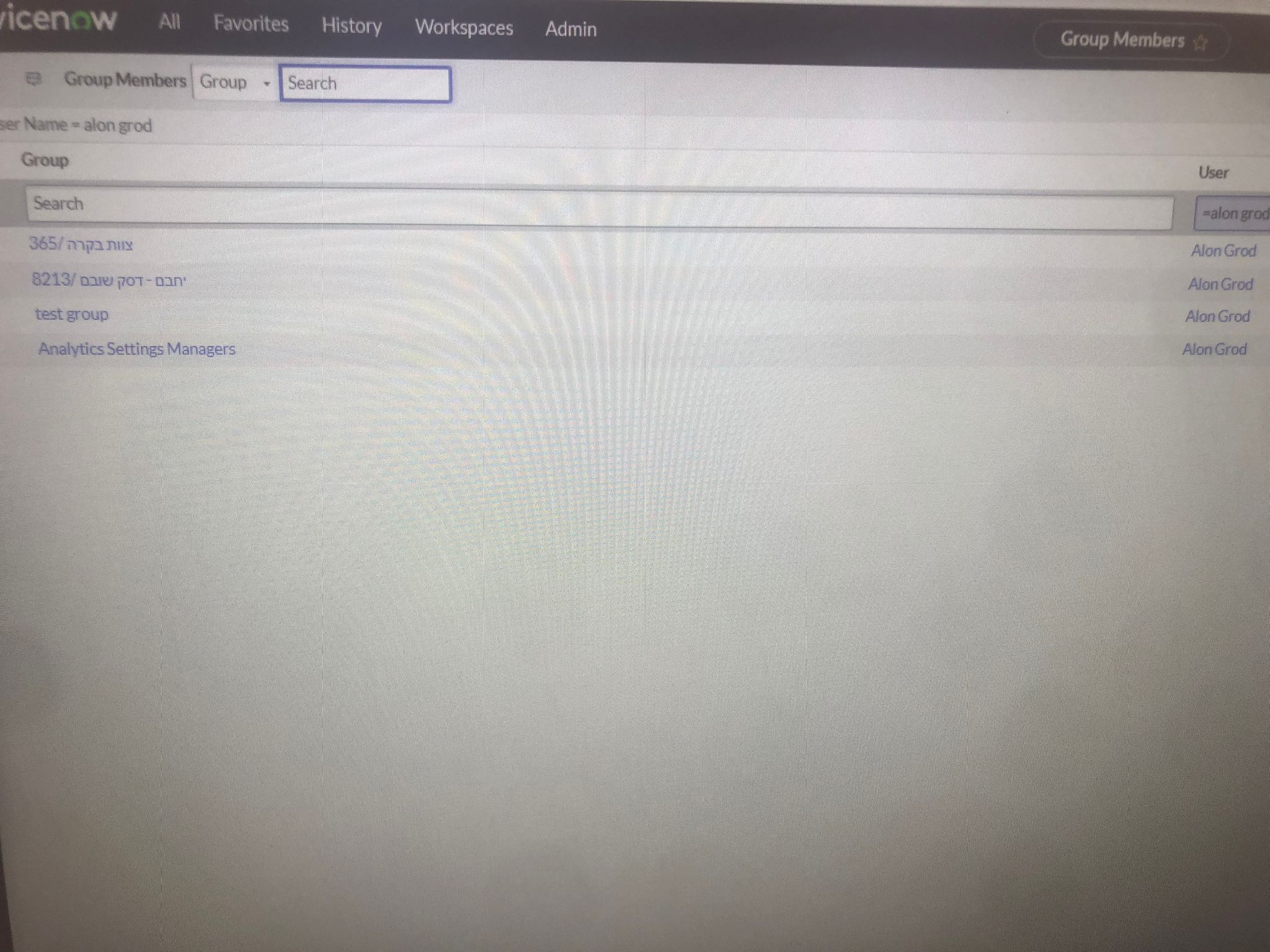

Im trying to add all the groups of specific user to a List field type called Groups.
What am I doing wrong?

I'd recommend avoiding taking photos and instead just post the code directly so it's easier to see.
But from what I can read from the photo's, it looks like on your client script you have "ans = and" on line 17.
Perhaps it's supposed to be ans = ans.
Also when using while loops for GlideRecord it's a good idea to use something like toString to make sure you're not including a reference to an object. For example in the script include I'd change arr.push(gr.group) to arr.push(gr.getValue('group')). (Or gr.group.toString() works as well)
