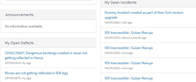

I want to show additional fields(including the default fields) in the record form opened from Service Portal homepage. For example:
I have couple of widgets on my Service Portal homepage that show 'My Open Defects' and 'My Open Incidents' respectively as shown below:
Now, when I open a defect record from here, I see following information on the opened screen:
ID, State, Priority, Created and Updated fields are displayed by default on the form as shown in the highlighted section.
-> Similarly, when I open an incident from Service Portal homepage, I see following information on the opened screen:
Now my question is, how can I add more fields(in addition to ID, State, Priority, Created and Updated fields) on the right hand section of the opened form ?
