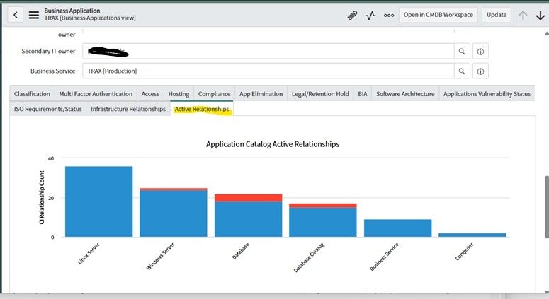

The ask is to display a dynamic bar chart report(already created and used on the cmdb_ci_business_app table) where a user can select the reference variable "business_services_to_modify" which is for the cmdb_ci_business_app table.  Once that is selected, the "Tagged Asset List" custom with label variable type variable will display the report "Application Catalog Active Relationships" which is a bar chart report that shows the active relationships (cmdb_rel_ci table) on the selected Business Service. I've tried to create a widget to display this but it doesn't seem to work as no graph or data show.  Any thoughts on a good way to accomplish this?  I attached a screen shot of a record on the cmdb_ci_business_app table where this report/chart is currently working.  They would like for this to be on a new catalog item and it's used in the Service Portal.

I was able to get it to start rending some data but I can't quite get it to render like the chart on the cmdb_ci_business_app form.  The chart I want to show is an embedded chart for a bar report.  Can't seem to get the correct data.

Here's the chart I want to show:
