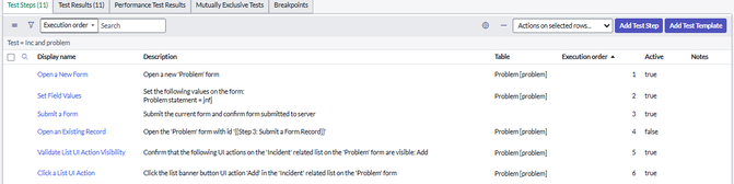

Hi Team,
Can anyone help With ATF Steps
How to ADD Incident in to the Problem related list using ATF.
i will able to click Add button.
I don't know how to filter and select
Steps:
03-05-2025 08:27 PM - edited 03-05-2025 08:29 PM
Till Click UI action "Add" working.
Please help me with the step how to select specific record in look up window
Steps:
03-05-2025 08:51 PM
I don't think you select any specific without using Click Custom Component UI Step
Did you try to see if you are able to find multiple checkboxes?
03-05-2025 08:55 PM
yes tried Click Custom Component UI Step but unable to filter out the records
