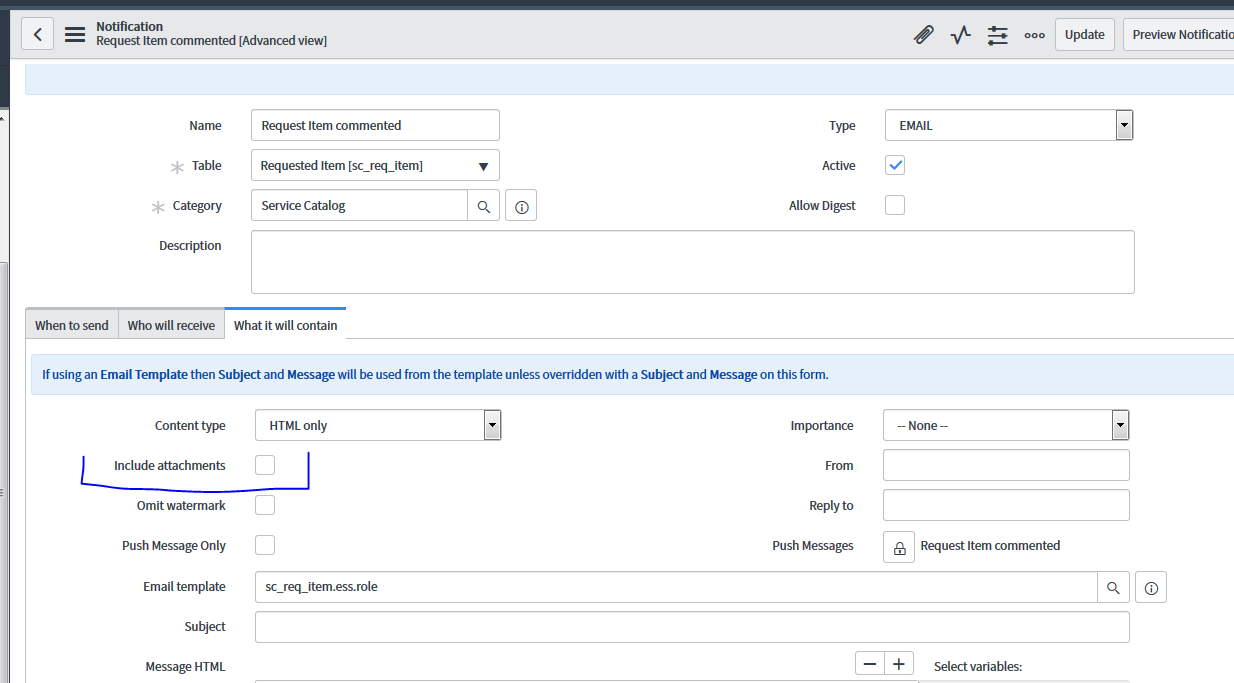

There are two other ways I see here;
1.  Link to the attachments via a mail script
2.  Update the notification to include attachments (goto the notification, advanced view, check `Include Attachments` it will include all attachments attached to the record at the time)

Jace Benson
