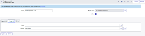

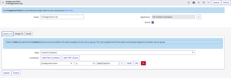

You can create a "Assignment Rule" on Incident table as shown in the example below,
so while creating any incident if user select the CI as "WEBSTAGING" once the record is saved it will auto assign it to "Database" assignment group.
Table : sysrule_assignment
Catch: If user is updating the existing record then first assignment group should be emptied first then CI should be updated and save the record then "assignment group " will get auto updated .
