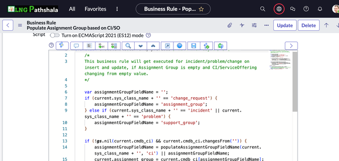

Hi @jaiho_rai
There is an OOTB (Out of the Box) Business Rule that automatically populates the assignment group. It follows a sequence and then populates the assignment group accordingly.
as you case is reverse you , you need to write your won logic and run the same on CMDB Table and there is no other to do without code.
