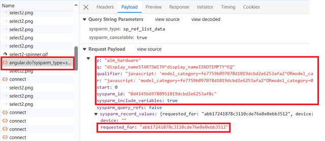

But when users expand choice list, internal request '/angular.do?sysparm_type=sp_ref_list_data' will be fired with non-encoded/encrypted payload like below.
The problem is that this payload can be manipulated and posted again freely.
So if someone wants to get unauthorized data, he can do it especially with manipulated 'requested_for' that can get easily in ServiceNow.
Once users get sys_id of important record, they can do many things with that.
Below is the scary result of 'GETTING ALL RECORDS' in asset table by simple modifying payload above.
Of course it is only possible with table that user has proper ACL.
But there are some important tables that open at minimal ACL such as asset(snc_internal), so you have to be careful when use reference qualifier with those tables.

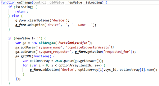

3. Converting reference to select_box, then fill it with catalog client script.
  - Select Box does not call '/angular.do?sysparm_type=sp_ref_list_data' so we can avoid payload manipulation.
  - Create client callable script and move conditions in reference qualifier into it so that manipulated payload can be ignored on server-side.
  - Get result with GlideAjax and fill choice list with it in onLoad/onChange catalog client script.
    Codes are like below.
  - Result : when catalog item is loaded, request to instance for filling choice list is like below.
     Of course, sysparm_request still can be manipulated, but it will be ignored in server-side if you developed right:)
