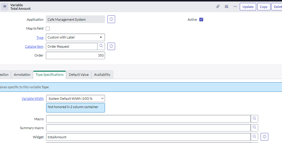

Hello Ankur,
I have tried it but I cannot seem to see the field.
This is the widget alongside the script:
It is showing like this, I cannot seem to see the field but the data can be seen in the alert.
Here is the config for the variable.
