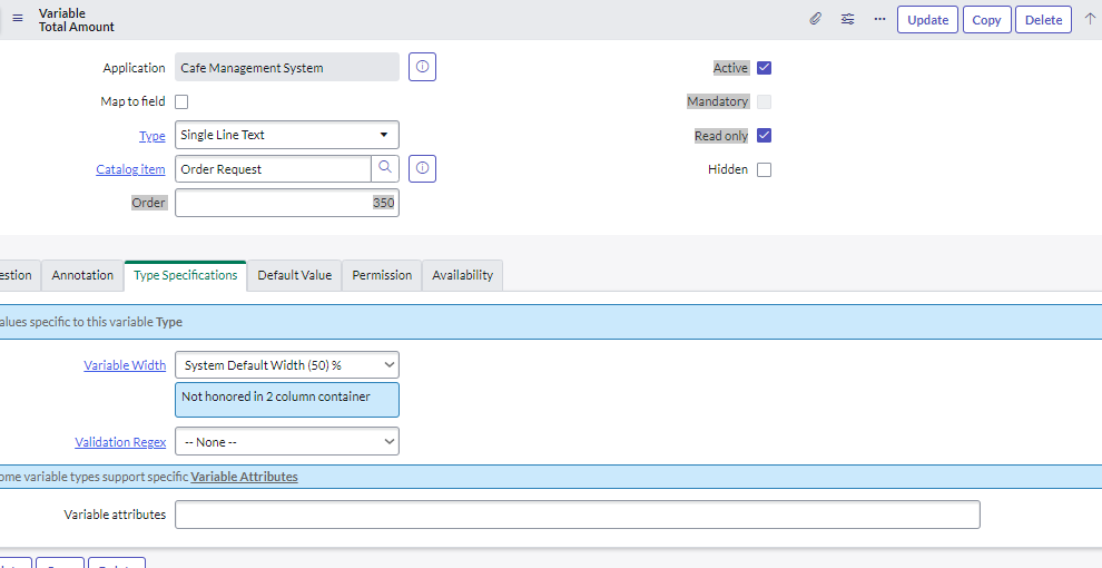

Is there a way to calculate the total for this? The quantity will still need to be multiplied based on the price per size of the drink and I wanted to store the total into another variable that is not inside the multi-row variable set.
Is there also a way so that every time they click add It'll update the total variable outside of the MRVS

Hello Kartik,
I wanted to use a single line text type but I have created a custom widget for handling the calculation as per what others have said. How may I connect the widget to a single line text type? Is there a way for it? Also I have confirmed that the script works as the alerts are working and giving the correct values.
Hi @John Clyde Ap[as
As per LOC#21, you should be able to set the value. Are you not getting the value? Also, confirm if you are getting the alert.
Kartik
Hello Kartik,
It is not setting the value on a single line text field nor a custom / custom mlabel variable, the alert works only if I use the custom label and connecting the widget to it.
Here is the script of the widget.
Since I was basing it on the thread you were able to give an answer. I would just like to ask a question if the process is still the same?  How was this achieved?
I tried it on a single text field but unfortunately it still won't show the value nor are the alerts showing up.
I apologize for the inconvenience. . .
