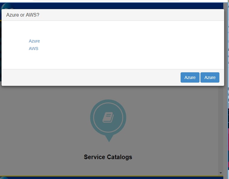

Any idea on how to center my modal pop up? When my browser is maximized the pop up is located at the right side
But when I minimize my browser to a certain width, it is completely fine and centered.

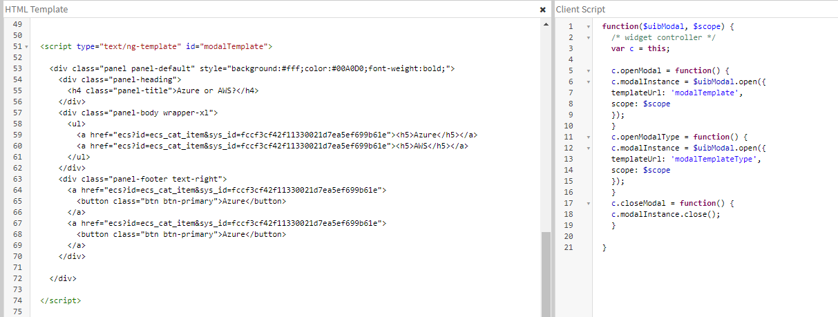

I used $uibModal in Client script.I just want it to appear at the top of the page and centered vertically. Here is the code in html and client script:
If you are using Chrome, try inspecting the element indicated here. In this example, I have purposefully added "float: right" to make the dialog appear on the upper right corner.
Without knowing more information it's hard to diagnose what could be causing the issue.
May I ask what should I be looking at?
