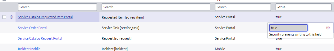

I have managed to make it show in the my_request widget, just a couple more questions if it is alright
Some of those items that are not a part of the table I'm wanting to show is showing up.
How may I do so, so that it will only show this filter and not the others.
I'm trying to make it so that the other items except "My Orders" are set to false but I cannot seem to do so.
Another thing is that the "Open requests" works as its showing up but I was wondering if do I have to create another my request filter for the "Closed requests" or do I just add a filter condition?
