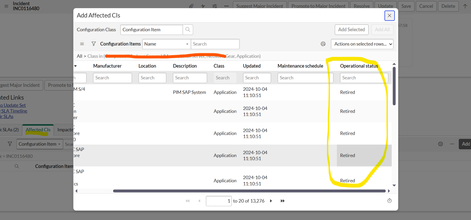

How to change the filter condition for below Affected CI related list?
kiran115
In the incident form, under the related list, when I open the "Affected CI" related list, it displays the records in a pop-up window. I would like to update the filter condition here because the current view includes records that have been retired. How can I modify the filter? I tried from my side, but this is somewhat different to update.

Hi @kiran115 ,
it's the script include AssociateCIToTask
update the highlighted line
if you want that to be removable filter use this

Hi @kiran115 ,
Please mark my answer as helpful/correct if it resolves your query.
Chaitanya
Thanks @Chaitanya ILCR, it worked.
