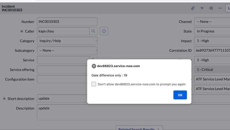

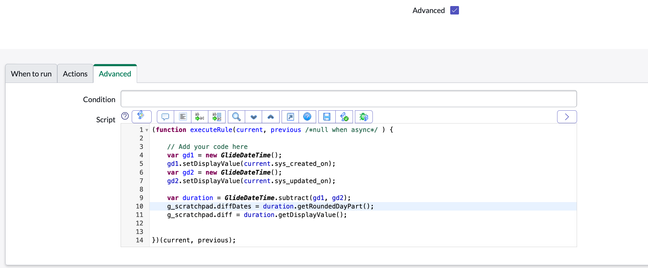

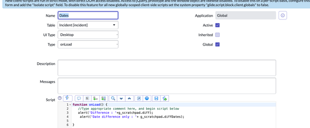

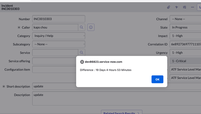

Hey,
As I see your pasted code, you have commented the first four script statements and then directly assigning the value of 'duration' variable. May be that's the case.
Below is the same logic and screenshot which I have implemented it's working fine.
Client script
Incident-
Hope this helps!
