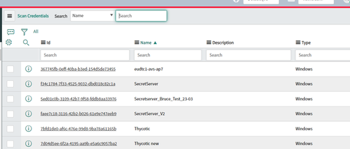

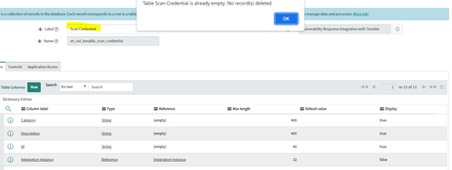

Hi Raghav,
I am trying to delete the records as you suggested, for some tables if try to delete records its showing table records are empty eventhough few records present.
