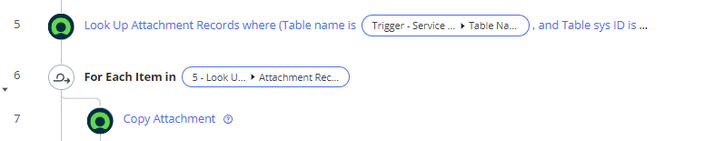

Uncle Rob
Yes, but I'd be using Flow Designer instead of Inbound Email.  Once there its much easier to just drag and drop flow actions that do the work for you.  Here's a quick example I made.
- First thing it does is Look Up Records in sys_attachments where the table_name is the Table Name of the triggering RITM and table_sys_id is the Sys ID of the same triggering RITM.
- Then I do a For Each looping through the Look Up Records action I just defined.
- Then I use the OOB Copy Attachment action which asks for the source attachment and destination record.  It gets the source attachment from the iteration of the For Each you're in and the destination record is whatever action defined your Create SC_Task.
