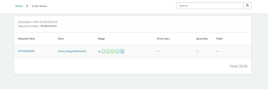

Hi David,
I checked your approach it stops the workflow in the "Wait for Condition" with the condition I shared previously, but when I close the task it doesn't update the RITM any more and the workflow is still running.
Regarding workflow, I was just saying that maybe I need a log message to complete the workflow correctly. Again I am quite new to development I don't get all logic yet maybe I am missing something on workflow side?
Here is the screen of "Wait for Condition" maybe I need a different stage there, since I put "Completed" stage in my log message.
I just guessed it might be logical way maybe I am totally wrong.
Thanks in advanced for ideas they were awesome, if you have anything else to add here, feel free to share, just don't want to put my task on you since you have already helped me greatly.
I don't think you need a log message, if you need a stage set on a workflow activity you could change the end activity to have the completed stage.
