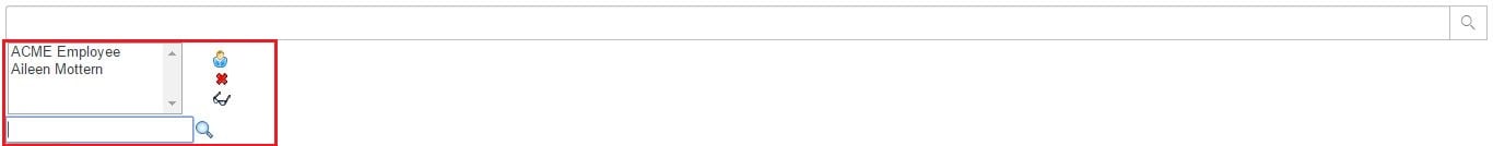

It looks like this. You can remove the selected value from glide list as well.
It invokes macro for glide list which is provided by servicenow.
reference attribute specifies to which table it should refer to. Here it refers to "core_company" table

<g:macro_invoke macro= "lightweight_glide_list" id="change_subsystem" name="change_subsystem" control_name="myListCollector" reference="core_company" can_write="true" />
