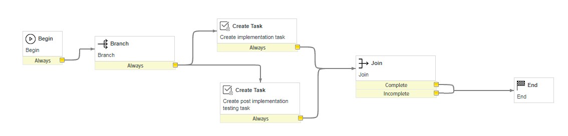

Can you post the screenshot of the Change WF. By the way what change is it? Normal/Standard/Emergency?
Normal Change
In the Workflow in the below block one more WorkFlow is being called
The name of the other WorkFlow is : Change Request - Normal change tasks where task is being created.
Below is the screenshot Where task is created:
Now to create the two new more task You need to add to more create task block in Change Request - Normal change tasks workflow like Below screenshot:
Arindam
wow, totally looked over that,,
now i see it..
thx so much Arindam
