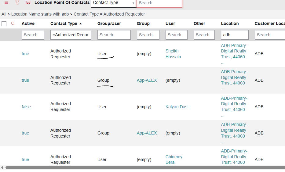

Hi Brad, Thanks for reply.. I have attached log screenshot..The error message displays into location contact field itself.  i have shared the entire script - there are 4 functions - check if not user contact type, check if not group contact type, check if other contact type(contacttype must be user or group), check if groupcontact type( contact type must be user or other). my script works correctly for first two function. but it didnt works correctly rest of the two.
pls advise the correction in the script:

Brad Bowman
Mega Patron
With this version of the script, it would be helpful to add a log line inside the for loop as the first step to show which u_group_user record is being evaluated, and the allowedTypes it is being evaluated against.  Note that with this structure, if ANY u_group_user values are not User or Group it will return true.  You are showing 5 records for this location that are a User or Group, but are there any other records for the same location?
