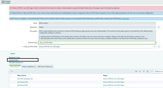

08-11-2026 11:35 PM
Hello @Alon Grod ,
Navigate to Multi-Factor Authentication > MFA Context :
Then Deactivate Policy :
