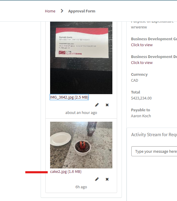

i am looking at the Ticket Attachment Widget in the ServiceNow Portal and i would like to know how to zoom in or open the attachment into a separate window instead of when clicking on the attachment it downloads onto the computer.
I want to be able to view the attachment without downloading it

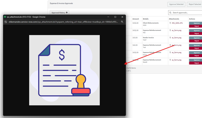

Yes i was able to find a solution but i wrote an entirely new Widget to get it to work.
here is the Service Script that i used in my code to make it work
if (!approval.attachments) approval.attachments = [];
approval.attachments.push({
url: '/sys_attachment.do?sysparm_referring_url=tear_off&view=true&sys_id=' + attGr.sys_id.toString()
