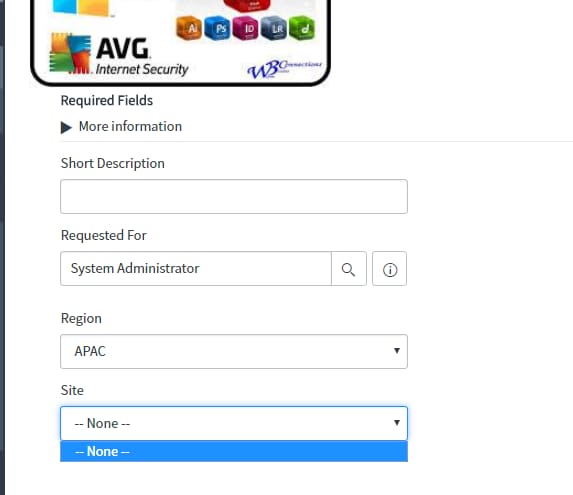

here i have two Choice list variables, so how can i get values
How Display Site values based on Region, .....&
javascript:'u_region ='+current.variables.u_regionnn is same script work for this also??? ,
i have tried it, but not working
site variables calling values from Desktop Support table (two fields is there 1.Location Name, 2.REgion)

In the Site variable, you need a reference qualifier
javascript:'u_region='+current.variables.u_regionnn
and set the variable attribute as ref_auto_completer=AJAXReferenceChoice,ref_qual_elements=u_regionnn
Make sure the back-end value of each option in Region in catalog form matches with the back-end values of each option in the region field on Desktop Support Location

In the site table, did you also add Variable attribute as

Thanks Sanjiv,
You have given grate Logical script here, Thanks!!!
