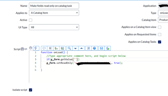

How to fetch current catalog task state inside catalog client script, so that I can compare if the state is close or not.
Please refer below image.

Hi @Obito ,
You can use code like below.
g_form.getValue('state')It will give you current task state value.

12-22-2024 11:34 PM
if your requirement is to make all variables readonly when task is closed then use this script in normal onLoad client script on sc_task and not catalog client script
function onLoad() {
if (g_form.getValue('state').toString() == '3')
g_form.setVariablesReadOnly(true);

12-22-2024 11:29 PM
you cannot access field value using catalog client script.
So g_form.getValue('state') won't work. But did you try that and see what it gave?
what's your business requirement
12-22-2024 11:32 PM
if your requirement says to use catalog client script then use GlideAjax
OR
you can use GlideRecord with callback
function onLoad() {
function myCallbackFunction(gr) {
if (gr.next()) {
if (gr.state.toString() == '3') {
// it's close complete
var gr = new GlideRecord('sc_task');
gr.addQuery('sys_id', g_form.getUniqueValue());
gr.query(myCallbackFunction);
12-22-2024 11:34 PM
function onLoad() {
