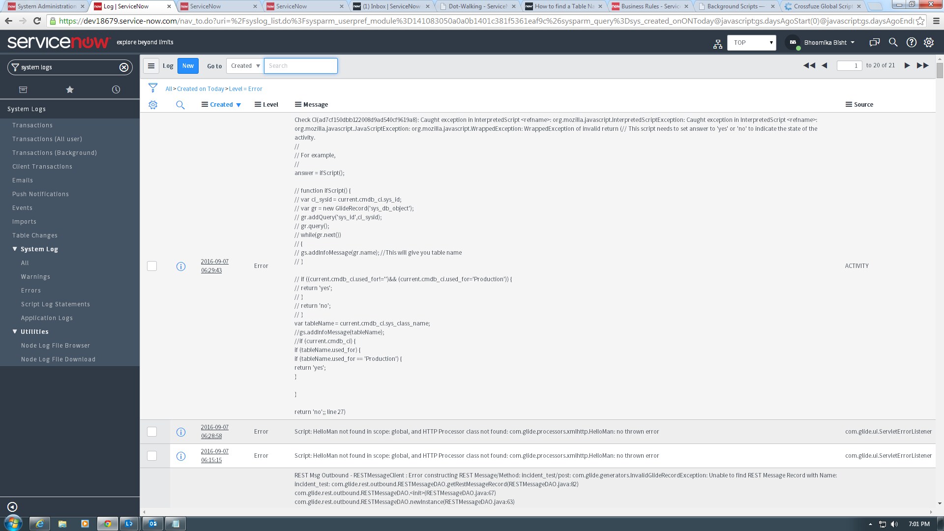

This is what i am getting:
And this in logs:
This is I am getting in Error Logs
Thanks & Regards,
Bhoomika
You commented out the critical parts the template gives you. The entire script should include:
answer = ifScript();
function ifScript() {
  if (current.cmdb_ci) {
      if (current.cmdb_ci.used_for) {
        if (current.cmdb_ci.used_for == 'production') {
            return 'yes';
return 'no';
BALAJI40
