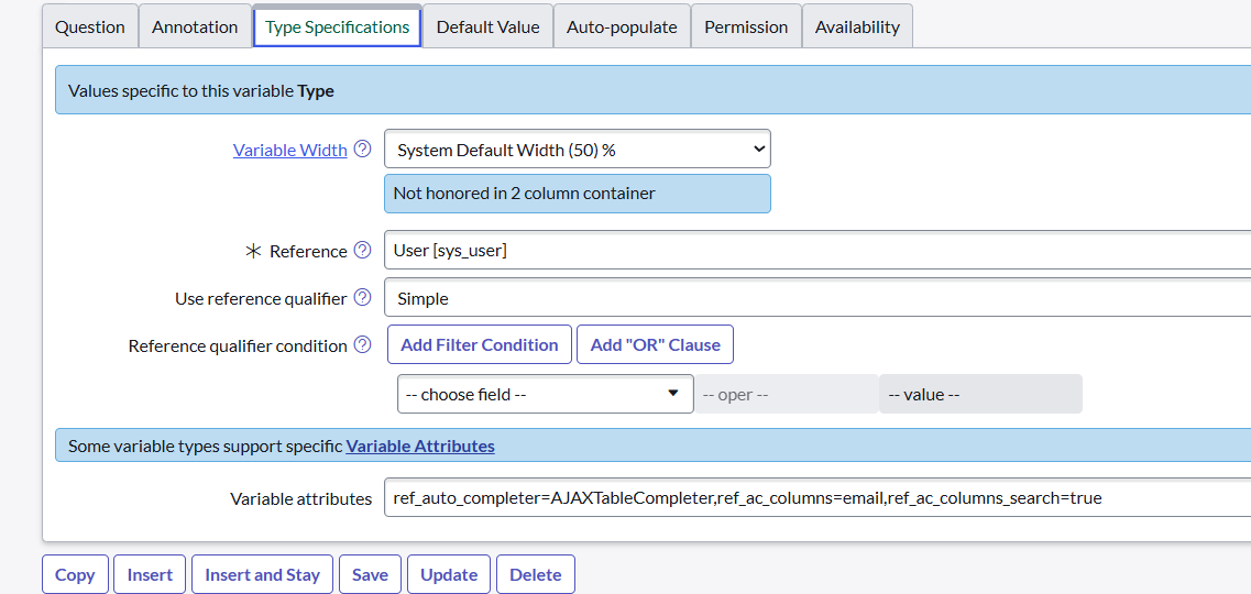

while you type you can show email address by adding variable attribute to that reference variable
add this in your variable attribute
ref_auto_completer=AJAXTableCompleter,ref_ac_columns=email,ref_ac_columns_search=true
