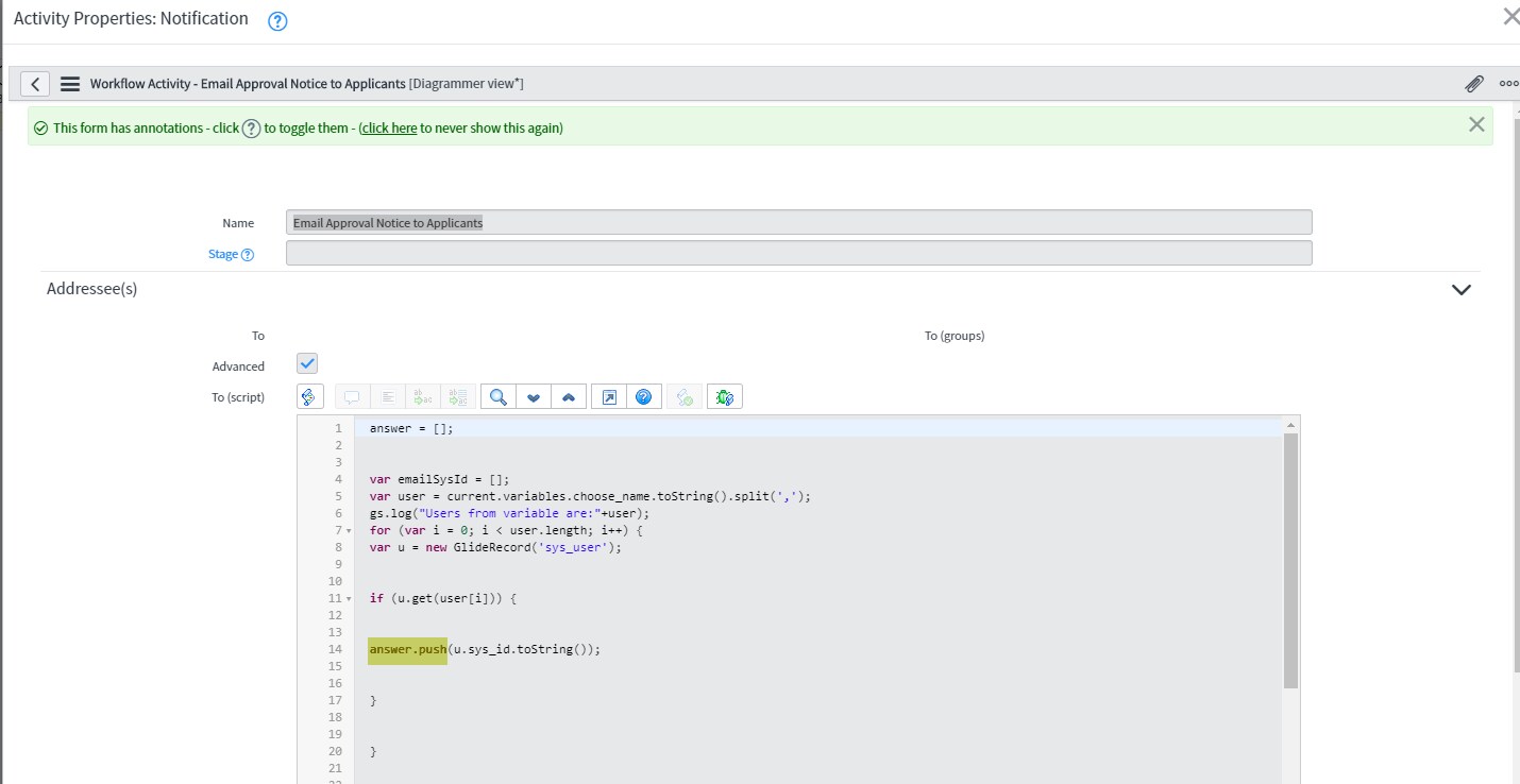

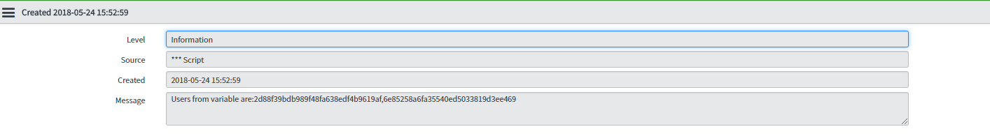

Hello Ankur,
Looks like variable value is not coming. gs.log result is undefined. Please see below.
KayB2
Kilo Contributor
I tried adding toString() to the var user and it looks like value(sys id) is coming. However, no emails were sent.
Please see below snips.
KayB2
Kilo Contributor
Hello Ankur,
Good news!
I replace emailSysId.push with answer.push(last line of script) and it works!
Emails are now being sent to all users selected from the List Collector. Fantastic!
Thank you very much for helping me out!
Kay
