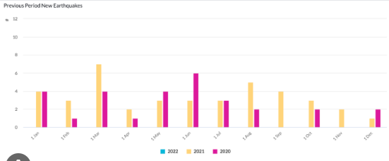

I want to get "Month" report side by side for 2 years. For ex, attached the picture. I tried creating Report with different types (bar chart, columns chart etc), but nothing is showing as similar to my requirement (to have side by side months for 2 years). I could only make Reports with charts straightforward ( all months come one after another and then month from next year starts. I don't want this way, i want like comparison month for years side by side). Could you please help/share me the step by step to achieve this?

Hi @priyaaprab ,
How much knowledge do you have in relation to PA? Based on that you know how to create PA jobs, Indicator sources and automated indicators, then it's quit simple.
- Ensure that you have data collected on the automated indicator back to January 2022.
- Create a widget with check mark in "previous period chart"
- In the previous period settings, set "range of periods" to "years"
- In the previous period settings, set "number of periods" to "2"
Above will give the following result:
Best regards
Anders

Hi @Dr Atul - LNG ,
Thanks for looping me in 🙂 - @priyaaprab, this is not possible through standard reporting / the report designer, you instead need to utilize performance analytics where you have the "previous period" available. Please see example below:
Best regards
Anders
