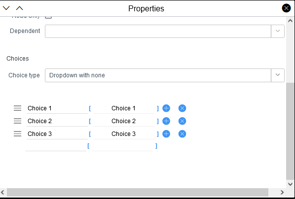

‎03-07-2022 06:35 PM
I've created a field name "u_test" with label "New Choice" on an incident form.
Created a onChange script on Field "New Choice"
return;
var value = g_form.getValue('u_test');
var text = g_form.getOption('u_test', value).text;
alert("getOption:" + text);
Execution result when Choice 1 is selected.
