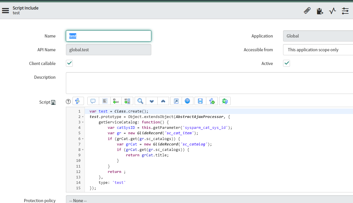

Hi @Nayan Mahato ,
i will do this solution if i should hide the button in ine catalog item i should hide the button for 100 catalog item with the catalog name is company

hi @Hitoshi Ozawa ,
thank you for your reply don't work i get on console
Uncaught TypeError: Cannot read properties of null (reading 'length')
and i want get the name of catalog i want once the name of catalog is comapny in client script i will do
g_for.setValue('no_order_now',true);
