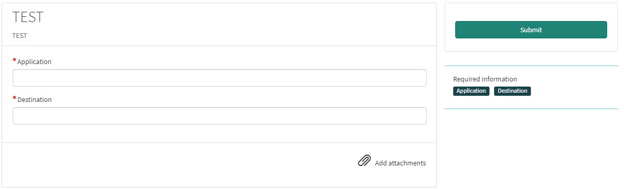

I have the following record producer on Service Portal.

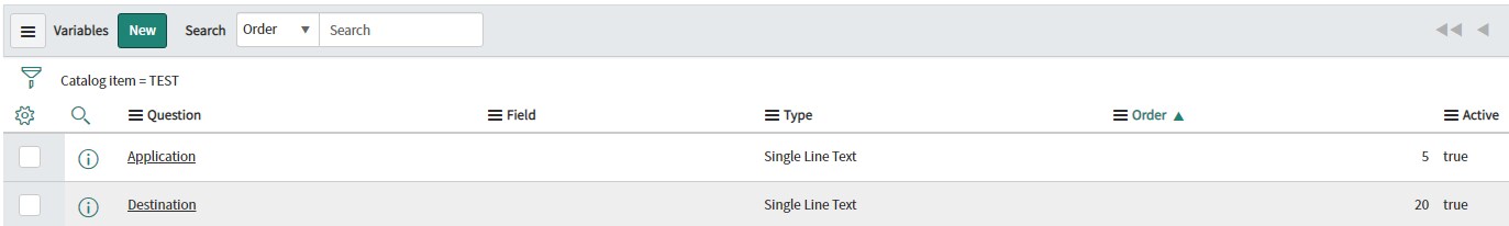

On backend, it looks like this:
I want to make the destination field (variable's name --> destination) invisible once the form is loaded on Service Portal.

However, when I enter on the record producer on Service Portal, I can still see the destination field (it supposed to be invisible with the catalog client script). As you can see the console.log statement works properly, but the g_form.setVisible() statement is not working.
Bare in mind that I want the destination field to be a mandatory field.
This mandatory field will be visible after, only if for example the user selects "Category A" from another choice field.
What's going wrong here? Any ideas are welcomed.
Thank you all in advance.
Smith.
