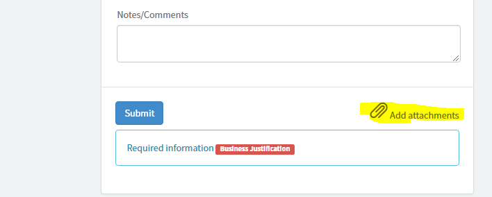

I want to hide attachment icon for specific catalog item in "Service Portal" view.
Note: I am able to hide on normal catalog item view but not in "Service Portal" The code which i have written is working on catalog item view but its not
working on "Service Portal" view even i have used "UI Type = Bothe" in client script.
Please suggest.

Hi Sumit,
If you have made it hidden using dom manipulation then it won't work in Service Portal and scoped app since service portal and scope doesn't allow dom script in client scripts.
As a part of workaround have your catalog client script to run in Global scope and then it should work fine.
