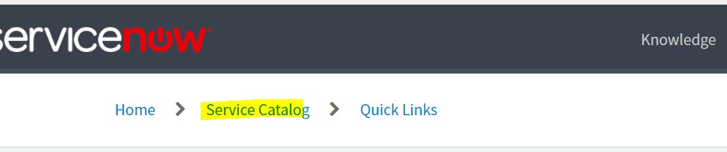

I'm trying to change the redirection of 'Service Catalog' in the breadcrumb.
Currently if we click on Service Catalog I see the page is being redirected to the page 'sc_home'. I'm trying to disable this redirection and would like to redirect it to separate page, onClick.
I have cloned the breadcrumbs widget and changed the below line in the HTML code
<a ng-href="{{item.url}}">{{item.label}}</a>
to
I'm defining the href link directly assuming this is what it is triggering the Service Catalog to 'sc_home' page. However even on my change it doesn't work and still redirect to the home page.
Is there any other place changes to be implemented for a successful redirection?

I finally figured out by restricting the links in breadcrumbs by adding the below lines in HTML template.
<a ng-if="item.label != 'Service Catalog'" ng-href="{{item.url}}">{{item.label}}</a>
<a ng-if="item.label ==='Service Catalog'" ng-href="?id=sc_category&sys_id=e15706fc0a0a0aa7007fc21e1ab70c2f">{{item.label}}</a>
Kind of hard code to 'Service Catalog' label which redirects to above URL and for rest of the links it works as usual.
