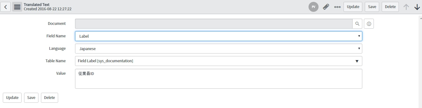

I give you another solution,
1st step : create your variable within the record producer in ENGLISH (it must be in English first).
2nd Step : Change the language of your snow instance from the settings (like for example french)
3rd step : Open again the variable of your record producer you created in the 1st Step.
4th Step : Erase the name in English, and replace it with its equivalent in the language and save it.
Example : in the 1st step you created a variable : "your username"
                                    2nd step : Change snow language in Spanish
                                      3rd step : open again the variable created in the first step (your username)
                                      4th step : replace "your username" by "su nombre"
Note : I did not say that delete the record, Just replace the name with its appropriate translation.

Owww I got the issue...
On the last screenshop you posted above, first bring up the "Name" field on the form. You don't have the name field that is why you don't have the label.
Then right click on the "Name" then "Dictionnary" and then the steps I mentionned in my previous post

I sent you all the screenshots to do the translation. At which step exactly   are you getting stuck ?
Open the record producer. Then create all your variables first. Then save. Once they are created, right click on the name of the variable, select the option configure dictionary, a new window should open, at the bottom of the page, you should have the label and name of the field and also the language option. Create a new row with your chosen language then save it.
To test it, From the setting, select the language (other than english), display the record producer and it should display the field name with the requiered language
