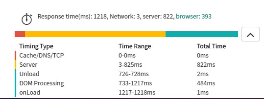

The page response time icon, located at the bottom of all pages. This does not show you the specific business rule causing the issue but is still helpful. additionally, you can view this information for all users in the transaction logs.
