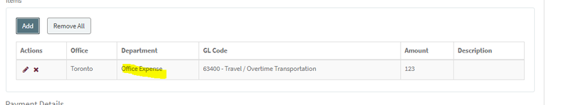

so i have a trick request to configure,
i have an MRV with a reference variables that is looking up on the cmn_department table
i want to have the ability to auto fill the other row users will select with the same value they selected in the first row of the MRV.
Example:
the Department Column u selected Office Expenses
i want every other row to only show Office Expenses and not have the users be able to select anything else but Office Expenses base on their first row
so all other rows will only have the Office Expense and nothing else
is this possible with an onChange script?
