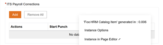

Getting Started - Identifying Your Widget with SNUtils
Before writing any code, you need to know which widget is rendering your catalog item page, so you know where to add the UI Script call. The easiest way to do this is with SNUtils, a browser extension for ServiceNow developers. If you don't have it, you can find it at arnoudkooi.com.
Do note: There are two extensions for SNUtils, one for on-prem domains, and one for service-now domains. My recommendation is have both if you work with both.
Once installed, or if already active:
- Bavigate to a catalog item on your Service Portal that includes an MRVS
- Right click on anywhere within the MRVS
- It will show a widget name:
Note this name. In our case, we were already using a custom clone of the OOB "HRM Catalog Item," but you may be using the older "Catalog Item V2" widget. - Navigate to sp_widget.list in your filter nav
- Filter for the widget by name, and open the record
If you are using an OOB widget, for best practices, you should clone a copy before performing this modification, to prevent conflicts for future upgrades. Keep in mind that after cloning the widget, you must also update the instances to use your cloned version instead.
- Keep this tab open for now

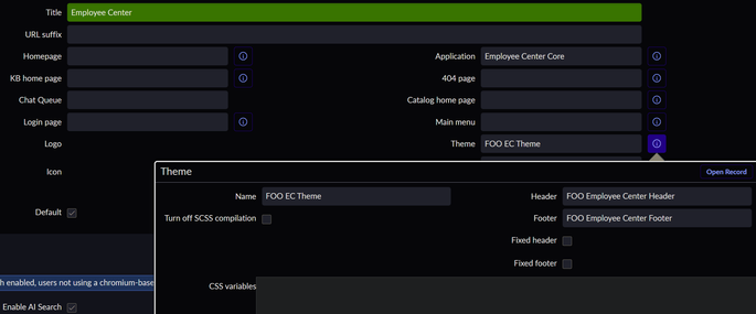

Then Submit. Open the theme of your portal by navigating to "sp_portal.list" in your filter nav, finding your portal, and opening its linked Theme:
Note: Make sure you are in the same scope as your theme is!

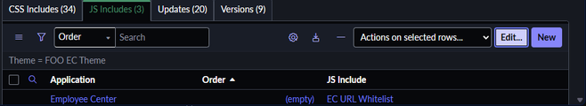

Scroll to the bottom, to the JS Includes related list, and choose Edit:
Search by Display Name, find and add your newly create JS Includes:
Save, and you're done with the theme.

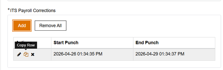

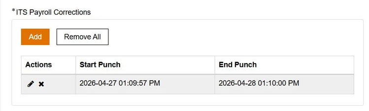

The Result
When a catalog item with an MRVS is loaded on the portal, the Copy Row button will appear alongside the existing edit and remove buttons. Clicking it inserts a duplicate of the selected row immediately below it, with all field values and display values preserved.
Before:
After:

<a href="javascript:void(0);" class="wrapper-xs fa fa-pencil" role="button"
data-original-title="Edit Row" aria-label="Edit Row {{$index + 1}}" data-toggle="tooltip"
data-placement="top" ng-click="c.updateRow($index)"
ng-class="{'btn disabled no-border' : c.disableMRVSActions}"></a>
<a href="javascript:void(0);" class="wrapper-xs fa fa-copy" role="button"
data-original-title="Copy Row" aria-label="Copy Row {{$index + 1}}"
data-toggle="tooltip" data-placement="top" ng-click="c.copyRow($index)"
ng-class="{'btn disabled no-border' : c.disableMRVSActions}" id="copy-row-{{$index}}"></a>
<a href="javascript:void(0);" class="wrapper-xs fa fa-close" role="button"
data-original-title="Remove Row" aria-label="Remove Row {{$index + 1}}"
data-toggle="tooltip" data-placement="top" ng-click="c.deleteRow($index)"
ng-class="{'btn disabled no-border' : c.disableMRVSActions}" id="remove-row-{{$index}}"></a>

});These scripts can then be added as dependencies on widget or theme level whichever fits your requirements.
Also to easily find the widget record from a portal page you don't need snutils. That context menu is servicenow native. Also you can click show widget customizations from that menu and then click on the i icon in the top right of the widget for a button to navigate to the sp_widget record. Or you can inspect the dom and the element for the spwidget directive will have a class that is in the format of v + sys_id of the widget record.
