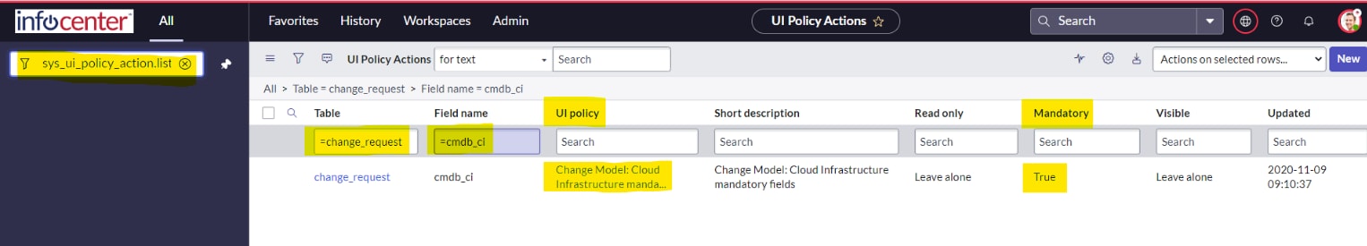

Hi there,
Looking at the UI Policy Actions table to see the individual field configurations from UI Policies is probably easier.
To get there, type sys_ui_policy_action.list into your filter navigator and hit enter, this will bring you to the table list view for UI Policy Actions, which you can then filter down for Table = change_request, and Field name = cmdb_ci as below.
Assuming your Change Request stuff isn't customized, it is likely this OOB UI policy that is making the Configuration item field mandatory on change requests:
