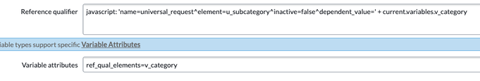

OK. I still don't have the table or Create New to see that form directly, but you can see what needs changed in this example. Both variables will be the type of Lookup Select Box. I'll use the names v_category and v_subcategory to try to prevent confusion with similarly named table fields. Both variables will be setup like this:
v_category will have a Reference qualifier that looks like this (change the name or element values if they don't match your choice list records).
v_subcategory will have a Reference qualifier and Variable attributes that look like this:
The Reference qualifier includes the dependency, and the Variable attribute ensures that the list of choices is updated when the Category variable changes.
