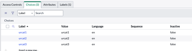

Trying to replicate what must have been done in your environment, I create a choice field named u_category on my universal_request table and added these 3 choices:

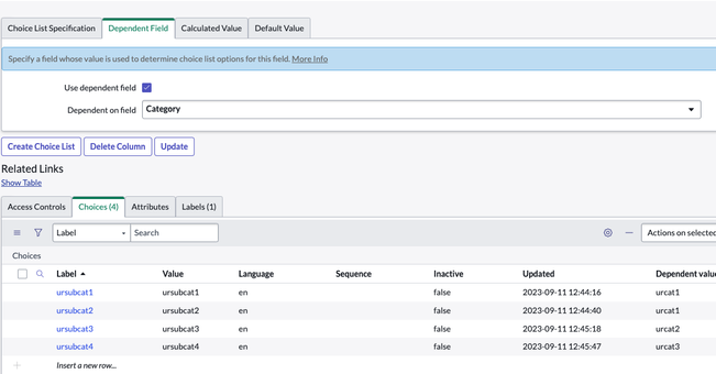

I then created another choice field named u_subcategory, dependent on Category, with these 4 choices:
I confirmed on the Universal Request record that I only see these Categories, and the appropriate Subcategories for each Category.  Does this look similar to your environment so far?

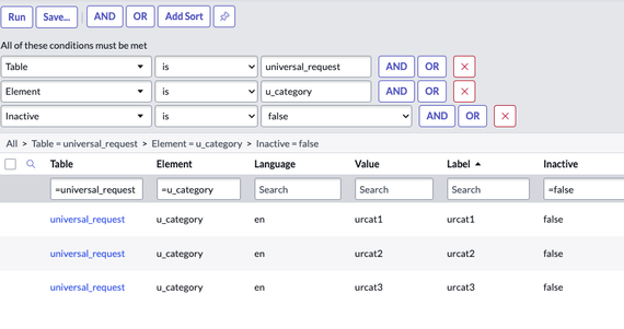

You can also try filtering a list view of the sys_choice table until you get the intended Category choices.  It should look like this:
Once you have the list view filtered correctly you can right-click the last breadcrumb on the filter and choose Copy query then paste this into the reference qualifier on your category variable inside single quotes following the javascript tag as pictured.
