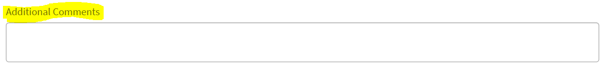

Hello Experts, I have a variable set type Add Row with a variable called "Service" which is a list collector.
what i need is that if a user selects "Other" from the list collector, a field that is not in the variable set called "Additional Comments" turns mandatory. I have done this with 2 regular  fields using a UI policy but not for a variable set, can you guide me on how to proceed?
Thank you

Tried with a UI policy in the form and in the VSET with no luck, did not find the UI Actions since I'm using a variable set choice to set a variable outside the VSET mandatory.
Thank you
